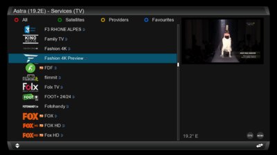

1) - Use the <up> or <down> arrow buttons. (SC_1)
2) - Select the service you want to apply the service that must be displayed after booting. (SC_2)

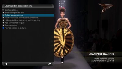

  • Press the <MENU> button.
  • Choose " Set as startup service ".

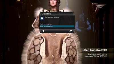

3) - Press the <OK> button and choose from the 2 options the one you want. (SC_3)
  • Note: generally i make the choice ( 2nd one ), "also on standby".
