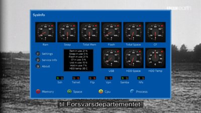

First to the heating issue my temp is about 35 degrees celsius and might go up to 40-50 when recording or watching recording.
So you might have a faulty temp sensor? Some issue with other devices to close. Have you ant\y way to do a manual messure with an external temp gauge?
Screenshoot here: and yes its not in the OBH image by default only me who stole this nice gadget from BH image and put it into my personal OBH Image.

ad) temperature, it may be an issue of internal sensors or software, I measured with my contactless thermometer the box and it was barely 40C
if you could share that sysinfo plugin that would be great

I cant share the sysinfo panel since its part of the BH Image and i have done my personal modification to have it in my personal OBH 4.2 image so i would break some copyrights for that.
