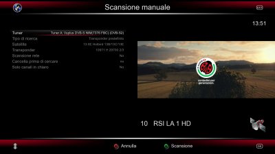

When ا make manual scan , press ok, another scan list appears to choice kind of scan , when press ok again i return to the previous scan list without scan
how can i solve this problem ?
i have vu+ duo 4k se and opbk 4.4.018
When I'm in the tuners menu, and manual scan screen, I have a circular red icon, with cancel, and green circular icon for scan.
It means
i have not
i use skin eclipsefire
It means you haven't updated you image for ages! Because I have EclipseFire, too, and the button is there.
What OBH version are you still on? This change is quite old now.
In case, download again the skin and restart.
