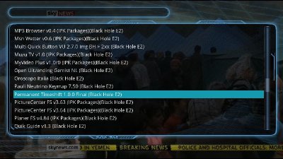

option one green/yellow/addons download manager/black hole addons pluggins then permanent timeshift 1.0.0 final (black hole e2)

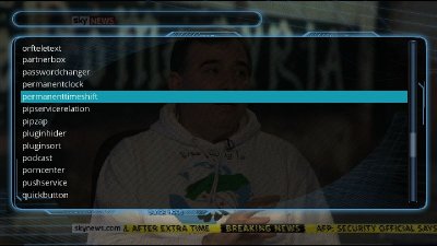

option two green/yellow/addons download manager/black hole feeds plugins then permanenttimeshift
i was using option two before, this was causing me green screen, i deleted this version, then i went for option one, everything seem fine now, no green screen when i press the record button
not sure what the difference is between these two permanent timeshift,
I used the 1st (permanent timeshift 1.0.0 final (black hole e2)) from BH 2.0.2 and it cleared the problem I had been having

Try to download "Permanent Timeshift 1.0.0 Final (Black Hole E2)" by green button/yellow button/addons download manager/black hole addons & plugins
Thank you. Your method works for me. Now the timeshift is full-auto and it does not crash when I press "record". This correct addon should be integrated into the images instead of the buggy one.
