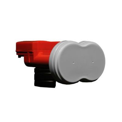

Thank you for your reply and trying to help me on this issue. I have just reminded that this LNB is not a simple LNB but it's a dual LNB (that kind of LNB that is for 2 satellites / 2 LNB's in one) that is used just for this satellite. I'm suposing that this kind of dual LNB probably has a diseqc (or something like that) implemented, that interferes with the other diseqc where are connected the 3 other LNB's.
Can this be a cause? Probably i should change that LNB; to replace it with a standard one.
Thank you!
Do you mean a monoblock LNB?
If so which other satellite is it pointing at?
You might have to use the advanced options, in the Tuner setup, to configure your LNB's, and try to get it working.
Exactly is this one. Just one of them is used since for Thor the LNB should turn/rotate somehow. Anyway, it's used just for Thor 0.8W.
