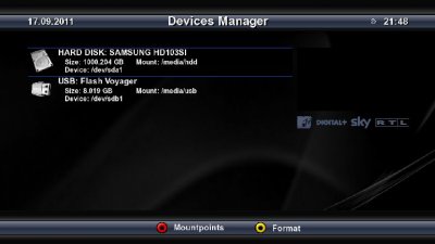

I updated the Sundtek drivers to the latest I think. To so so I use enigma2-plugin-drivers-vuduousbsundtek_20100924-r1_mipsel.ipk which connects to your server and hopefully downloads the latest version. Can you confirm this is the correct way?
I am installing on BH 1.6.5 and I don't see the Sundtek Media Pro in devices Manager so I am not sure the new drivers make it seen by BH image. That is unless I am not installing the drivers correctly, stick works perfectly btw.

The device manager seems to show up storage devices but not other USB devices, our stick of course is no storage device.
You should just see it in the tuner setup if it shows up as a second or third tuner it's just okay.

Thanks, I have always seen it correctly in the tuner setup, however it doesn't show in BH USB tuner so I don't think it's detected by BH.
Can you confirm how to correctly install your drivers and if the steps in my post are correct?
