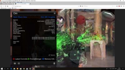

More: Gui version from 2015.01.25
Firmware version dated: 2018.04.07.
Take a look:
This is your screenshot.

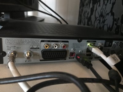

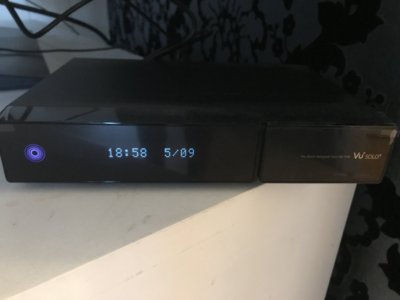

To despite, can you please upload some photos of your STB?, as:
  • Front cover
  • Upper cover
  • Back cover

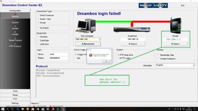

Have you typed in the box network configuration
Gateway 192.168.1.1
and
Primary DNS 192.168.1.1
DCC connection via router and not crossover
Your computer and box are connected via a router?

Please, do a screen grab of your image info screen by finding the appropriate menu and then typing in your browser your IP address followed by /grab
(it seems to be
192.168.1.2/grab
because we think you have a very, very, very old image installed.

Here you are: you are running OpenBlackHole 0.1!!!! A pre-beta-experimental version of OBH.
If you consider that OBH 0.4 was still very experimental, imagine, how much developments have been done since 0.1.
We had the 0.4, the 0.6, the 1.0 and finally the 4.1 with its 35 updates....
P.S. You'd rather save that image grabbed by right-clicking on it, and not posting your whole PC screen ;)
