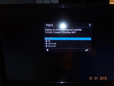

Do not lie, from the beginning do not erase any satellites from the file satellites.xml, if you delete it, you will lose it and then it will be added, they are a few kbs in data size.
If you have correctly configured the tuner, you can delete it, but as I say, it is a few data kbs to have / remove them.
Continues without understanding how these tuners work, by knowledge or by language (sorry for the translation).
If you come from normal receivers, the issue is a bit more complicated.
In Enigma, the receiver points all the data of the channels that it has in the file lamedb, then see that tuner has available the receiver and its configuration, when you want to tune a channel of such satellite, according to availability, so it comes.

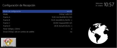

Your installation:
You have to configure the Tuner A: with all CBand (about 12) around 12 satellites in C band and only in this tuner, perfect.
You have to configure the Tuner B: with all KU 6 Satellites (the satellites 6 that are and only in this tuner), perfect.
The rest of tuner has to be in automatic / not configured (depending on the image you have).
As more tuner is needed, the deco uses them for the 2 tuners.
I do not have C-band satellites, but set Tuner A with satellite 1 and Tuner B with satellite 2, the 6 tuner receiver uses them interchangeably for the 2 satellites, you do not have to do anything, 100% verified.
I comment it because it is not necessary to update the list of channels according to which tuner you tune the satellite / channel, that is "automatic".
Important, if you make changes in the configuration of the tuner (which satellite and why tuner), when saving saves the changes, in these decos with enigma (linux), they are saved in memory, to save the file, you have to restart GUI , to finish, reboots the deco completely so that everything is 100%, the satellite.xml file is only read at the start of the receiver
I would ask for photos of the configuration of Tuner A and B, made from the receiver, using the PC browser, put the IP of the deco, enter OpenWebif, under the virtual control, you have the option of "Screen Capture", the You upload it to the forum, it will look much better when there are many data.
I hope not to liarte, a greeting.
No te lies, de entrada no borres ningun satelite del fichero satellites.xml, si lo borras, lo perderas y luego toca añadir, son unos pocos kbs en tamaño de datos.
Si tienes correctamente configurados los tuner, los puedes borrar, pero como digo, son unos pocos kbs de datos tenerlos/quitarlos.
Continuas sin entender como funcionan estos tuner, por conocimientos ó por idioma (lo siento por la traduccion).
Si vienes de receptores normales, el tema es un pelin mas complicado.
En Enigma, el receptor apunta todos los datos de los canales que tiene sisntonizados en el fichero lamedb, luego mira que tuner tiene disponibles el receptor y su configuracion, cuando quieres sintonizar un canal de tal satelite, segun disponibilidad, asi procede.

Tu isntalacion:
Tienes que configurar el Tuner A: con todo CBand (about 12) alrededor de 12 satelites en banda C y solo en este tuner, perfecto.
Tienes que configurar el Tuner B: con todo  KU 6 Satellites (los satelites 6 que sean y solo en este tuner), perfecto.
El resto de tuner tiene que estar en automatico/no se configuran (segun la imagen que tengas).
Segun se necesitan mas tuner, el deco los usa para los 2 tuner.
No tengo satelites banda C, pero configurado el Tuner A con el satelite 1 y el Tuner B con el satelite 2, los 6 tuner el receptor los usa indistintamente para los 2 satelites, no tienes que hacer nada, verificado al 100%.
Lo comento pues no es necesario actualizar el listado de canales segun con que tuner sintonices el satelite/canal, eso es "automatico".
Importante, si realizas cambios en la configuracion de los tuner (que satelite y por que tuner), al salir guarda los cambios, en estos decos con enigma (linux), se guardan en memoria, para salvar realemten a fichero, tienes que reiniciar GUI, para terminar, reinica el deco completamente para que todo este al 100%, el fichero satellite.xml solo se lee en el arranque del receptor
Te pediria fotos de la configuracion de los Tuner A y B, realizadas desde el receptor, usando el navegador del PC, pon la IP del deco, entras por OpenWebif, debajo del mando vitual, tienes la opcion de "Captura de pantall", la foto la subes al foro, se vera mucho mejor cuando son muchos los datos.
Esperro no liarte, un saludo.
Ejemplo: Configuracion_DiSEqC_4x1_FBC.jpg
