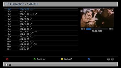

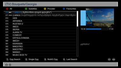

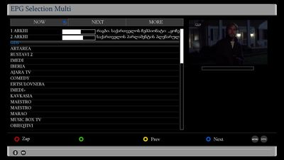

I have trouble with Unicode font and EPG.
Where to place the font with Georgian support? Sylafaen.ttf for example.

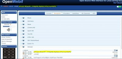

With WI of my Dou2 I can read EPG correctly.
added sylfaen.ttf to /usr/share/fonts but EPG is still not visible
It's not a simple thing to do and it's not enough to add a font that support your language.
It's a skin's font matter and you need to modify some strings of the file skin.xml so that the font you added can be used.
