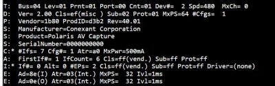

    How to install a driver for usb-t2 HiVision HU472-DC, vendor 1b80:d3v2 rev.40.01. the driver found here
    how to install it? help.
    Thank you!
