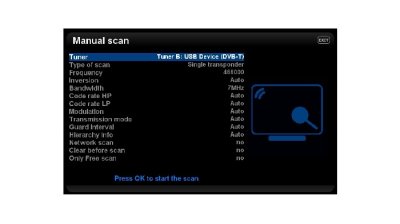

Request USB DVBT C tunner REQUEST [dw2102]
in the sacn meun it is display DVBT not DVBC

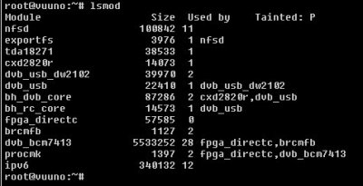

- log into your box via telnet
- send the following command:
depmod
- connect your device
- reboot your box

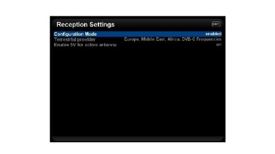

- take a look into Tuner Setup panel (standard Enigma2 panel) if you have the additional tuner.
- report here any info you want (support, not support, working, not working, etc)
