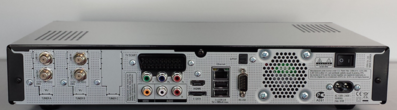

I was planning to change my single LNB's with Dual connections , so i'm gone have 4 cables , 2 for Astra & 2 Hotbird.
you had suggest me to choose ---> 2 DVB-S2 tuners, dual tuner module..
That's why i understood on my VU+Duo2 i'm gone have 4 cables, two connections for each Tuners-LNB's.
Do i miss something >?
i attach a photo of example.
is this as you suggest me on your previous message ?? --->> 2 DVB-S2 tuners, better choose the dual tuner module. ???

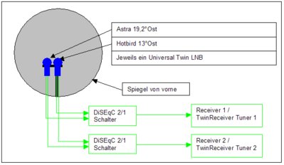

You don't need 4 cables if you gonna have only 2 sat tuners in the box.
You need to connect each pair of cables from the LNBs to a DiSEqC switch (port A: Astra, Port B: Hotbird).
So you'll have 2 DiSEqC switches from which only 2 cables come out to your 2 tuners.
Think i've got it..
Is this diagram what i need to fix ??
Thanks
