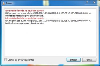

i don't know if i am alone with this problem, but since i setup my newly duo2 i can no longer play movie from
the opênwebif interface, i am playing movie locally so it is not even over Wan that occurs!
when i enter the web if and that i select to stream a tv channel from the webif => stream TF1hd
media can't be opened:
VLC can't open « http://192.168.1.254:8001/1:0:1:12D:3E1C:13F:820000:0:0:0: ».
port 8001 and port 8002 are both open in router in tcp/udp but nothing changed.

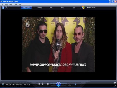

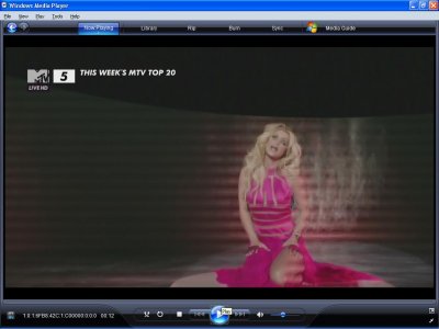

If I can watch with Windows Media Player
then it has to go with VLC.
Enable OpenWebinterface.
I can use Full Stream (PC stream)
or mobile stream.
Depending on which port I use.
And I have chose in the Transcoding Setup.
Transcoding Setup starting automatic selected port.
You can use ports 8001 and 8002
for PC and mobile streaming
and you can chose which one .

i tried with the exemple you gave with mtvhd on astra 19°2 est and i still have the same problem nothing open and still the same messsage,
