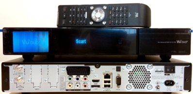

Hi again. yes I have Duo2 and on the back I have like the photo Tuner A installed, the other slot is empty
What is written , next to both tuner connectors
LNB in or LNB out
If you have 2 times LNB in You have dual Tuner
If you have 1 time LNB in and 1 time Lnb out you have single tuner.
With Dual Tuner you can record only from one the same transponder with your antenna instalation .
