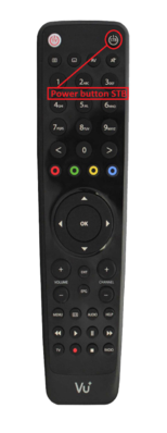

System Code Change for Vuplus Duo / Vuplus Solo ( 1st generation STB´S )
The default system code is Mode 2.
Mode 1 : SOLO / DUO
Mode 2 : UNO
Mode 3 & 4 : reserved for future models.

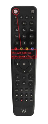

Press <<2 + 7>>, <HELP>, <0001>
The steps are:
1.  Press <2> and <7 > ( simultaneously ), on yor remote control unit ( RCU ) for three seconds until LED is on.
2.  Press <HELP> key
3.  Press ( digit ) <0001>
After 3. phase the remote will blink twice and should work normally in DUO.
2.  Press <HELP> key
