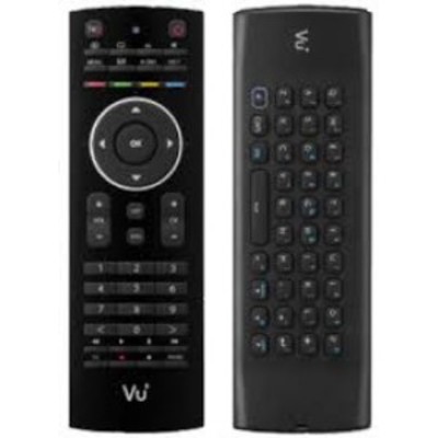

hi any boday using the double sided vu remote iv seen advertised one side is the remote the other side is a key board there black with the vu logo at the bottom there are £39 there look good
