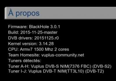

Image Black Hole 3.01b show 8 tuners A=>H = A B C D E F G and H !

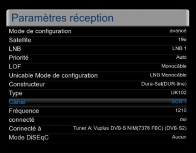

I have a "DUR-line UK 102 SCR Unicable LNB"
See the config.
This one work but not very fine on astra 19°east, I can get only 7 records simultaneously (don't know why)!
I use only one cable connected to LNB1.
I have made the 7 records on those frquencies :
11494 H
12402 V
12551 V
11895 V
11111 H
11156 V
11598 V

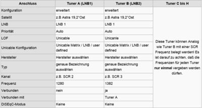

Here is the congig for the tuners, for one sat and LNB unicable.
Anybody can translate the text on the right of the picture ?
