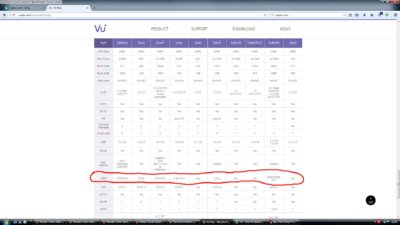

Thank you Mick but on their website there are no mention about capacity and most of all thickness of the HDD.
I don't even found any email or page for technical support, just vendors enquiry.

You can't have looked at the comparison information chart, at the bottom of the page:

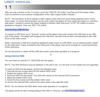

According SOLO4K Manual the maximum thickness size is 9mm so ... 9,5 or 12,5mm are not recommended.
Note: The maximum capacity you can buy for example "Western Digital HDD" ... the bue mobile series or the SSD one is 2TB.

Thanks nunigaia, this is what I was looking for I'm ordering now a Seagate Barracuda 2TB (ST2000LM015) that I think can fit the sled in the Vu+ Solo 4K
BTW, where di you find the manual? I was just able to fine a bad scanned pdf version of it aon teh official Vu+ website
