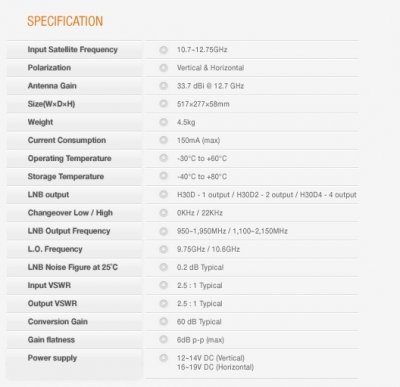

The dimensions of the dish are 47,5 cm, 26 cm, 7,5 cm. (LxWxD) Yes its a square dish :) which equals a 60cm dish http://i-do-it.co.kr/
This in combination with a Stab HH90 Rotor which is equal to a Stab HH90s (special for Selfsat because of a smaller pole to attach)
I think its not the dish as everything worked without problems on the Homecast. Also it works perfectly smooth, as long as my VU Solo is turn on.
Attached the full specs of the dish/lnb.
