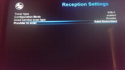

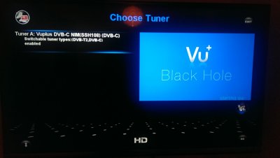

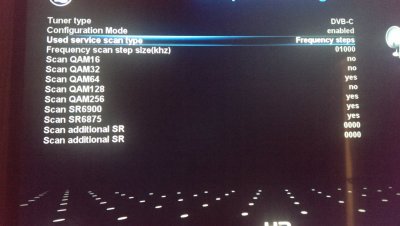

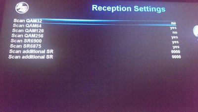

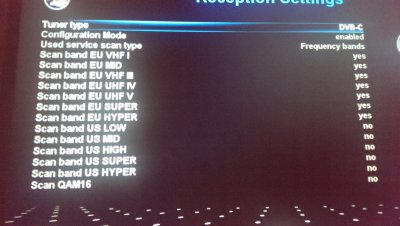

Solo Vu+ Solo SE - poor tuner??
Well, the same USB could not flash the SOLO the 4th time. New USB made it work (WTF??)
Oh well, I have Black Hole on now, with cables.xml
and still nothing works. Only 1 SID found.
Im starting to cry :/
Ofcourse - attached

Set the provider to CableBruteforce All and then go to manual scan, change type of scan to complete, and then Network scan to Yes and try again
I tried to do the CableBruteforce and automatic scan - it found 89 channels this time!! Thats something. Many channels seem "scrambled"...
So any frquencies I might have missed ?
...and why is the freqeincies different to the Duo2 list ? weird...
Well I think that proves that the SoloSE and the tuner are both ok.
