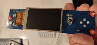

Hi,
english is not my mother language but will try to explain what is the issue with restart/shutdown menu poping immediately/randomly. The issue is with the front power button, not IR. Had the same issue so I dismantled the front panel and the PCB from front panel. When the front panel PCB is not conntected to front panel (only by flat cable to the main PCB) then there are no restart/shutdown popups. After the front panel PCB is attached to front panel then the popup is raised almost immediately. There are three screws used to attach PCB to front panel, two next to the front power button; if this two screws are tightly screwed then the front power button is touching the sensors on PCB and sending wrong commands to the receiver. I added pad (from thin cardbox) between the PCB and frontpanel and don't have any restart popups anymore

Any pic of the process you might taken???? Dont wanto to open up the wrong screws. Do i need to open the entire box????

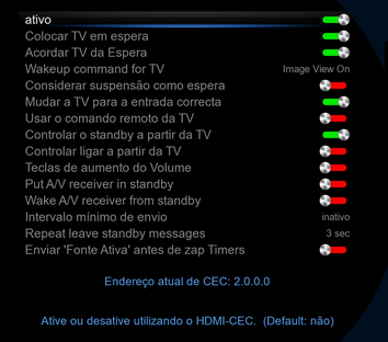

Did you check the HDMI-CEC settings in box/Bravia?
My configuration:
My configuration:

I can replicate this on my Vu+Uno4Kse so i supect that the touch button is broken.
If you go to the front of your STB and long press the touch button the Shutdown & Restart Menu opens

Yap. i confirm. it is the front button. Took off the front panel, connected the infrared cable ans she worked like a charm.
Maibe its a contact. gonna try to find out how to fix it
