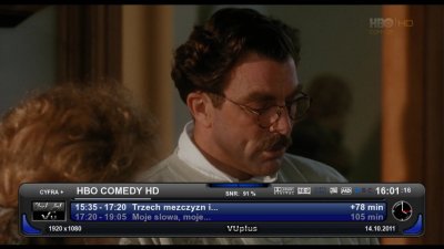

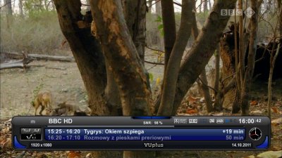

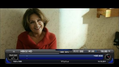

No problem here on VU Uno and sat list from @Likra

for me it all works without problems.
Maybe you not made ​​a good update and image installation.
Try again to make update and image instalation.
