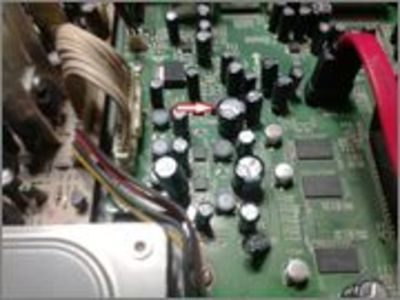

Today i borow Vu ultimo from one friend of mine, his reciever work perfect on my triax. Than i go at his place with my Vu, and on his antena my reciever still dont have signal on that TP. i figure out that all dvbs2TP with frequency 115xx and 116xx not work.
Then it sounds like a hardware fault, especially if you're starting with a new image, and not installing any backup, or plugin.
You could take off the cover, after unplugging the receiver, and check for any obvious signs, bulging capacitor, etc... But if it's a failed/failing component, and not an easy diagnosis, or repair, is it worth the expense of fixing it?

Limba could you please tell me if you dismounted motherbord for capacitor replacing or only cut the capacitor pins? At the moment it is all right on your VU DUO?
