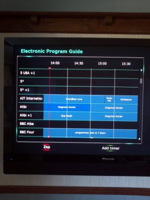

Made the move from VIX to BH 1.7.0 running ****** 1.38. Done my channel scans, installed my bouquets, no extras installed. I am only on a static dish pointing to 28.2E but I have noticed a number of channels 5 USA, comedy central and a few more that I can not view, they are there in the bouqet but no listings shown. I have updated my satellite.xml but to no avail.. Can anyone help me please ?

These channels have changed frequency a while ago, so you need to either download an updated channel list, or do a scan yourself to get the channels back.
mrmad1966
Thanks Evo, I did carry out a full automatic scan & this did 'see' them. Although I am using a rather dated bouqet, could this be the cause ? Thanks
