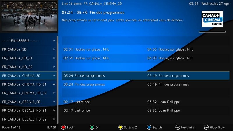

Hi all,
As I have seen in another post, the X-Streamity screen looks bigger than my TV. When I scroll through the channels in the playlist their name is partially cut off on the left. Is there any way to fix this?
I also can't find any settings in the main settings that are related to resolution or OSD size.
Thanks in advance.

Hi all,
Thanks in advance.
I have the same problem...Does anyone know how to fix it?
New skin Blackblue for hd and fhd with Pig
Thanks marwen
