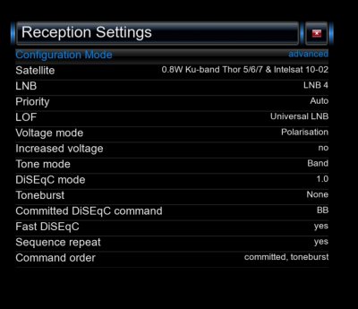

This is my first experience with FBC tuners, so my "usual" DiseqC settings may not be the best. I attached the settings of 1 LNB. Please have a look. The rest of LNBs are essentially the same (only difference is the committed command).
I have the 4 LNBs in advanced mode in Tuner A, tuner B is looped through tuner A.
I tried simple mode with DiseqC A/B/C,/D but the problem got worse!!
Your suggestions are welcome :)

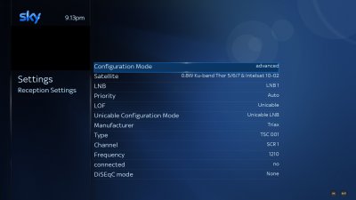

You have fbc tuners but i guess since you have 4 lnb in your satdish they are regular LNBs and not Unicable/SatCR?
If one of the LNBs are new type UniCable/SatCR you could experince this problem.
You have a very strange setup my friend. I would connect all LNBs to the diseq and connect them to my tuner A
If they are multi LNBs then you need a simular setup with a new cabel from diseq 2 to tuner b.
But if you have an UniCabel/SatCR lnb and 3 regular. then you need a new cabel all the way into your STB from the new lnb and leave the others in the diseq.

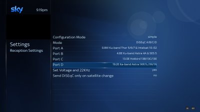

This is how i setup my UniCabel/SatCR from Canaldigital Norway and regular lnbs
Tuner A Unicabel attached and Tuner B Attached to diseq 2 separate cabels in to the house

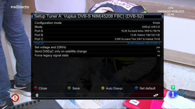

Have you tried something like this?
Note: The Diseqc ports [ A, B, C and D ] must be configured according your SAT lnb´s. This is just an example for UNIVERSAL LNB´S with diseqc 4x1. If you set the wrong input, you´ll get "no signal".
