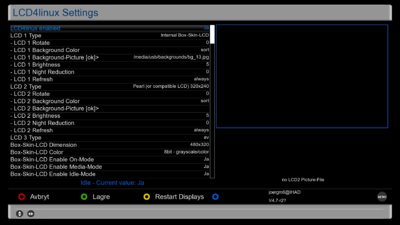

Have done following :
1. Installed LCD4linux from BH server
2. Transfered Evo's config , each in respective folders
3. Generated picon forder in media/usb and transfered my 220x132 picons there
4. Have enabled "LCD4linux " on in the settings .
4. Rebooted the reciver , picons appear on TV skin infobar , but not on the LCD display
What am I missing ... ?
Have attached screen from LCD4linux setting
You could try pressing menu and then load default config, but other than this I really don't know, I am no expert with lcd4linux, I just know after playing about with the settings it does work (but I have disabled it on my box as I don't need it).
