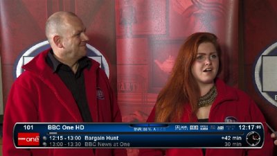

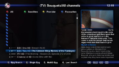

@phoenix hi mate did you get chance to make this quick tutorial m8. Mine scans OK showing all channels populated free sat and sly. My trouble comes now that bbc1 is not on 101 but on 1. In my skin display I can see it says channel 101 above my picon. But using remote channel 101 actually takes me to channel 207 itv2? Its like all the separators above are being ignored.
