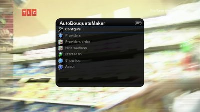

Is there an auto bouquets plugin that works with bh 2.0.6 rev C guys
Thanx
I'm using the Autobouquets as posted on this forum on a Duo2 with BH 2.0.6.C with no problems at all. I've even tested the new Alpha release with AutoPicons and it works well too.
Hi all. I am new to this so please bear with me. Which version of autobouqet maker will work with my latest BH and which folder do I install it to. I have a VU+ solo and Dreambox control centre. I assume I can use this to make bouqets for 13e and 19.2e/ many thanks
ftp post 23 ipk to tmp using dcc mate then manually install (green button>yellow button>manually install ipk packages. once installed download package in post 52 and follow the instructions ... i.e ftp and overight the files in the specified directory using dcc
I have manually installed the ipk package but it does not show up in my plugins. Should I be able to see it in there?
Its a system plugin m8.... Press menu>Setup>service searching and should be up top of list.
Did you copy the other files over using DCC?
yummer that sequence you give is wrong. I am havving same problem with that autobouquets and bh2.0.6. I had it working perfectly but silly me I decided to try a new skin and got the GSOD so started from scratch. That autobouguet is manual install, green yellow, then select ipk. I know as I have done it 5 times hoping it would work. But I get error message and file disappears. I download one from add ons with ------- but it loaded and rebooted but does not work either.
help
help
It says parse error or something mate but it still loads... I know I've had it working on all my BH images version 2 and over :s
help
this is the ipk that works for me buddy.... once installed like i said,extract and ftp the files over writing all when asked using dcc in the .zip folder to \usr\lib\enigma2\python\Plugins\SystemPlugins\AutoBouquetsMaker\ then reboot the receiver like @pheonix explains in post 52.... works for me on my duo and duo2

Got is working right.
Used dreamboxedit to download bouquets to folder on PC..... which fails but gets most of required files.
Then used fillezilla to transfer services , timezone.xml, terrestrial.xml and satelites.xml from the /etc/ folder on box to the folder created on PC.
(Don't know why they are in the /etc/ folder and not /etc/enigma folder)
Then open the folder with dreamboxedit, this shows errors but does open,
then save and reopen, and I think save again and all seems to be fixed!
Then just use dreamboxedit to send the files back to the VU+ box and restart, fingers crossed all is now as it should be! worked for me.
Absolute legend! Cheers boyofford. I dragged my Favourites bouquet to the top and turned off the scheduled scan to keep it there :)
