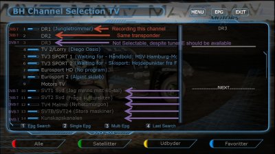

The "Tuner handling system" is acting almost as if there is only one dvb-t tuner (I think)

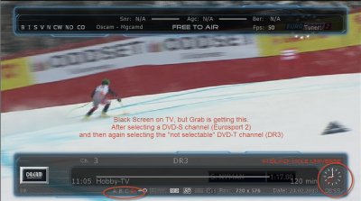

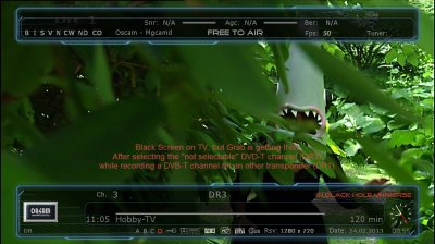

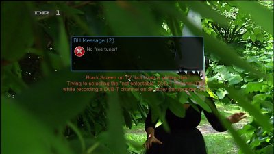

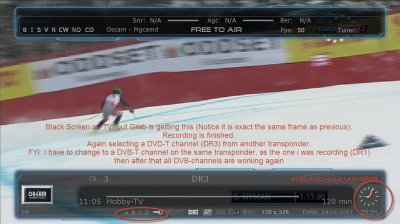

While recording a DVB-T channel
Watching another DVB-T channel on the same transponder is OK
Watching another DVB-T channel on another transponder,
then the usb-tuner 2 is not giving me any picture on screen, only black screen, signal quality and strength is OK

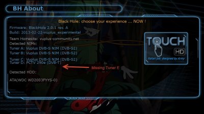

Try, only for my curiosity to remove one of DVB-S2 tuners, to have only four (4) active tuners on system.
BH2.0.5 Rev. B with 2 * Twin DVB-S Tuners (4 tuners in total) AND added new drivers vuplus-dvb-modules-vuduo2 - 20130819
Nano 290e in rear usb (second usb used for picons)
Not showing TUNER E in Tuner set up??
Thanks...
BH 2.0.5
Tuner A: Vuplus DVB-S NIM(AVL2108) (DVB-S2)
Tuner B: Vuplus DVB-S NIM(AVL2108) (DVB-S2)
Tuner C: Vuplus DVB-S NIM(AVL6222) (DVB-S2)
Tuner D: Vuplus DVB-S NIM(AVL6222) (DVB-S2)
Tuner E: DVB-T TV Stick (DVB-T)
Tuner F: DVB-T TV Stick (DVB-T)
Tuner E&F is usb dvb-t dual tuner (it9135).
Everything is working fine.... so far :). I have to do stress test on usb dvb-t tuner. I need rock stable tuner like these in inner slots.
