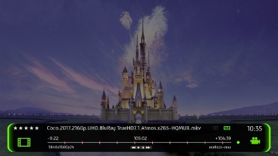

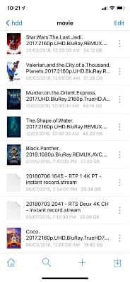

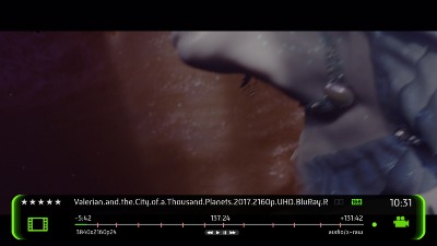

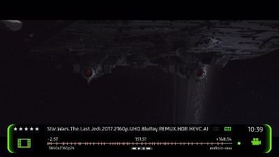

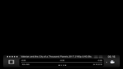

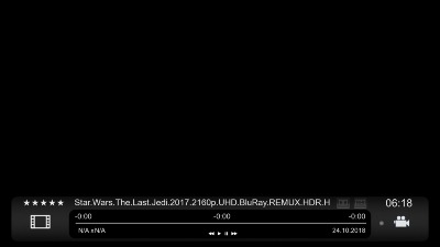

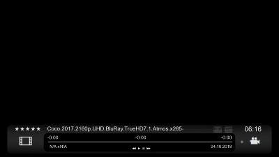

The last image of blackhole 3.0.6 is really fast & good but there is a little problem with 4K movies is not working in hdd
The same 4K movies it’s working OBH
Blackhole is not the best image for media playback, it is restricted by what codec's vu+ support in there git.
Blackhole is good for just watching satellite tv.
If you want the best media playback, then you are better off using the OBH image (that is why we created it).
There are 2 images for a reason, we didn't do it just because we could.
