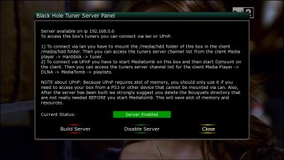

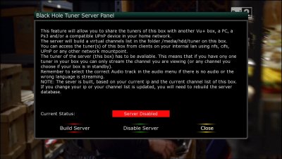

It will be a double post but i still have the same problem...
When i press build server for tuner , it says that the server is built it creats the directory /media/hdd/tuner but there is nothing under \tuner....
I did not try but can this be a problem...I have USB disk attached to my DUO ; do you think that there might be a conflict writing the files when building the tuner server files ? (i do not think so but....)
Am i doing something wrong ? Anyone got an idea ?
Check the name of all your bouquets. No special characters including ( ).
One default bouquet that you may have is "favourites (TV)".
Make sure you remove "(" and ")".
