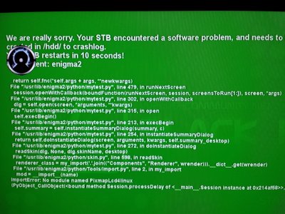

I installed the LCD settings, dis work for minutes and the my Duo2 crashed...En restart in a circle...I tried to re flash it...did jot work? °!I really don't know to to solve this. Plea see help and find my attached ceash file. Thanks

Hi,
What you have installed ?
Lcd4Linux??
If you have installed Lcd4Linux ,He is already within image and you should not install again.
Have you made ​​image update after image installation ?

Finale I could flash the box again and I made an image update. The installed Lcd4linux does not work for me??. Max. I will get the channel name on the LCD screen, no weather??. Why?.. Solution????? Thanks
