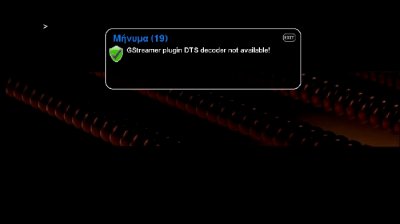

Why I Get an Error when i play DTS media files(Image 2.0.6 Ver C)?
Error is "Gstreamer Plugin DTS decoder not available"
I have uploaded the media file and a picture with the "Error"
"Attention" Downmix must be disabled(Inactive)
