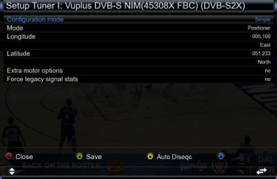

one tuner I
Configuration mode simple
Mode postioner
Longitude and Latitude for your location

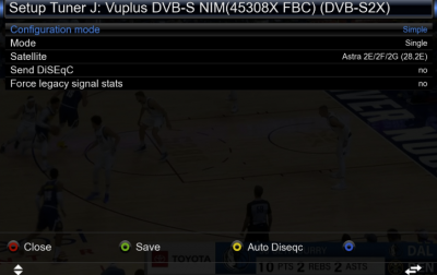

another physical tuner J
Mode single
satellites 28.2
or vice versa First J and second I

Thanks for this, tried that but can't loop through from virtual to physical. The only option I get from the physical tuners is either FBC Automatic or FBC SCR .. Maybe try a different image?
Even I am no longer sure what these physical tuners are (letters)
because you seem to have configured the wrong tuners
and that's why nothing works.
Use Configuration mode simple
so it will be clearer.
Each physical tuner has three additional virtual tuners
The dual SAT tuner has a total of two physical and 6 virtual tuners.
Eight tuners that can be tuned independently to the desired transponder inside the receiver
It's not up to the image
you are trying to configure a virtual tuner
so you only have the advanced option.
You need to configure the physical tuner it has
Configuration Mode simple

1. Attempt one : Re-imaged device the device, terrestrial tuners disabled, tuners I & J were offered by image to be configured and were configured in simple mode with USALS and 28sat respectively. No channels from either of these tuners
2. Shutdown new imaged device : replaced slots of where sat and T tuners were fixed and attached cables. Started device , configured tuners A & B now and all working as expected.
