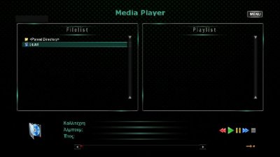

the problem is i tranfer a movie in the harddisk which it has greek name.avi and then
i go to the menu > media player > Toshiba HD it list the movies but the greek names movies they look like this
'yC 2012.avi
also when i click on this movie it plays the movie and in the LCD screen it show this strange name not the name of the movie that is show correctly when i connect with ftp and ssh or telnet.
media player where it takes the fonts? i think is problem with the media player now.

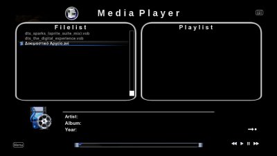

try it yourself in a flash disk or hard disk add a file named
Δοκιμαστικό Αρχείο.avi
then go with the menu button> media player >
and see in the filelist the name of the file.
in my receiver is shown as i q.avi
in yours?
Matrix10
in yours?
:help:

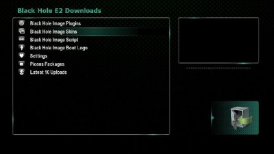

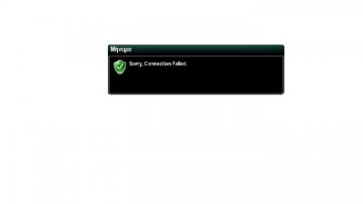

when i go to Black Hole E2 Downloads everywhere i click (screenshot.jpg)
i get Connectiob Failed (screenshot2.jpg).
I didnt change anything to the image i just install it as usuall from usb.

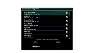

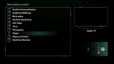

The only thing is working is plugins (screenshot3.jpg)
which there is not any skin with the name you call it.(screenshot4.jpg)
do i do anything wrong? does screenshot.jpg works for you?
