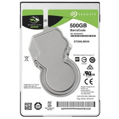

Vendor model:
Seagate Barracuda, 500GB, 5400 rpm, 2,5' SATA III
Capacity: 500 GB
External / Internal: Internal
Filesystem: Linux ext4
Note:Formatted via enigma2 Hdd menu.
Ok on Vu+ SOLO 4K receiver.
