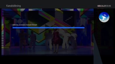

NO On ABS-2 i can see channels on SR 45000 DVB-S2 but NOT on 51,5 E SR 45000 DVB-S2
3 diffeent TPs
But with solo2 i can!

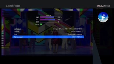

Again, how strong is the signal if you go to 52 E at the same frequency and polarization
As on 51.5. (Transponder you can not see on duo2)
I wonder if that is the problem ????
It is the same 98-100% i do hawe the same position on my dish

On ABS-2 75E 12153V DVB-S2 SR 45000 2/3 8 PSK i got all channels
Se post 3 from me there is a problem on SR 45000 on that satellit

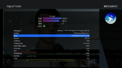

Well I said DUO2 there is no picture (no scan only 2 channels) and Ultimo 4K has TV pictures (coded , with EPG info).
The same antenna.
Both receivers have a signal over 80% channels with SR 45000
More than enough.

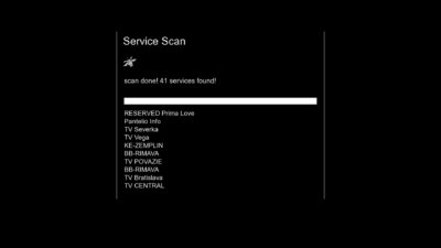

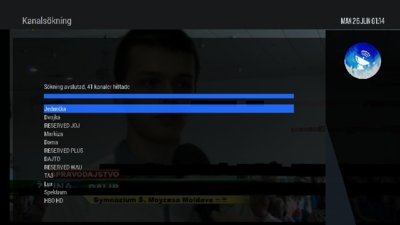

Ultimo 4K Scan 41 channels

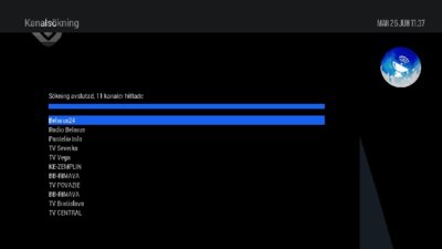

Duo 2 Scan only 2 channels with SR 20000
Signal on both Duo2 (with uploaded channel list) and Ultimo 4K
No TV on DUO 2 only Belarus24 and Radio Belarus ( scan ok for this 2 channels with SR 20000)

As you can see from Matrix10 the Ultimo 4K Scan 41 channels
When i transferring my channel list, from my Solo 2 it not works on duo2
The same antenna.
More than enough.

I've added a channel list to DUO 2 from Ultimo 4K ( so the same list and the same antenna)
The situation is the same.
Even the signal is stronger on DUO2 on TV screen a few percent than on Ultimo 4K but there is no picture on DUO2.
It is clear that we do not see channels with SR 45000 5/6 on Duo 2 with strong signal.
What does that mean exactly what I wrote earlier.
That the signal strength on TV screen of different receivers is not a measure of the tuner quality
This measurement is not accurate and can only be used as a relative indicator
Not as a real difference between the receivers and the tuners
Here with DUO 2 it is something else that they can not show the picture with high SR .
So the theme name is totally wrong.( I have rename)
We do not know what the reason is because the DUO 2 tuner has the same good reception of all channels
Which can be received as Ultimo 4K.
With exception channels with SR 45000 5/6
