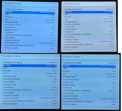

need your HELP urgently ... right now all i can watch is the default channel list!
Tuner A = 16/1 LNB (Diseqc 1.1)
Tuner B = 2 LNB (Diseqc 1.0)
Tuner C = 2 LNB (Diseqc 1.0)
it can scan A but doesnt receive any channels there.
no option of scanning Tuner BCD.
cant upload (new BH v 2.0.4) image from USB (FAT32)... nothing happens!
so where am i doing it wrong?
thanks
Try to configure diseqc 1.2
yes i did the Advanced setup, still no scan!
please see my Diseqc 1.1 LNB setup in the pics
Hi
Configuration Mode: Advanced
LNB: 1-16
Committed Diseqc command: None
Diseqc Mode: 1.1
Fast Diseqc: Yes
Command order: Uncommitted, Committed, Toneburst
Uncommitted Diseqc command: 1-16, use the same as the chosen LNB (1-16).
