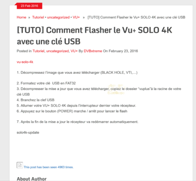

I just read this Howto, which was certainly not the good one. Thank you so much anyway.
