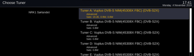

The problem at tuner A ( see the screen shot ) is that you have setted the tuner cumulatively to ( 19,2 East, 0,9 W and 0,9W ). Even if you have an Unicable LNB, you can´t set severall postions ( LNB1 ) without a Diseqc device.
A diseqc device can use severall LNB´s ...
Now you have it running, if you have turned off at tuner A settings the positions not needed, all it was ok.

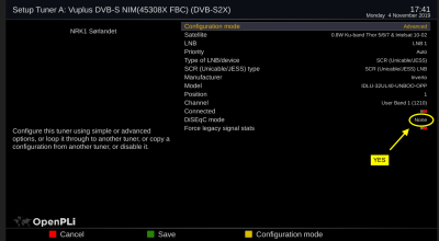

Exactly. As I wrote, he hadn't set the DiseqC. So it couldn't work.
And, @Nor50 , it was not necessary to reflash if you had followed the advices you got. The day you'll learn how to configure your tuners, this will be clear even to you.

No problem with the DiSEQc and settings. It's the Unicable LNB that has problems.
What do you mean is wrong with my settings there?
0.8 west is an SatCR-lnb and has nothing to do with the input from the Diseqc-switch
