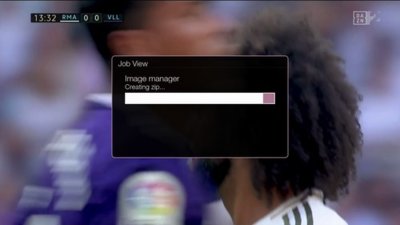

FullBackup Done without error and all Right

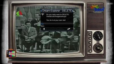

The problem occurs when you are using the image in OMB and then try and create a fullbackup as it creates the fullbackup to /omb which is the same location the image is running from (as the Zero4K only has 1 usb port).
So the solution for this, is to use the usb format wizard and partition your usb stick with more than 1 partition (this will mean it will delete everything on the usb stick, so back it all up first if you don't want to loose anything).
Then mount 1 partition as /omb and the other as something else and create your fullbackup to the 2nd partition (you need to go into the fullbackup option, press menu then change location to the 2nd partition).
Then it should create your fullbackup without issue.
I see .. you are right

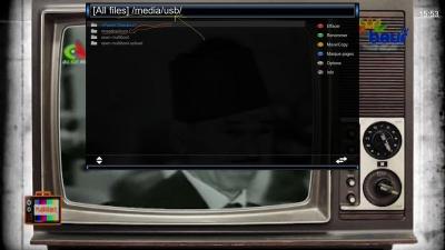

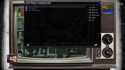

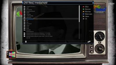

The problem has been solved and for the benefit of the members, the problem is that the Full Backup are in the the OMB in defaut.
The solution is when entering the Menu Full Backup we find the path on the OMB and we change it to HDD for example. We save the settings and exit the menu and go to the usb path where there is omb and we find that he created the imagebackups folder delete him . Then we go back Menu Full Backup and do the process in the usual way. all w'ilbe ok
