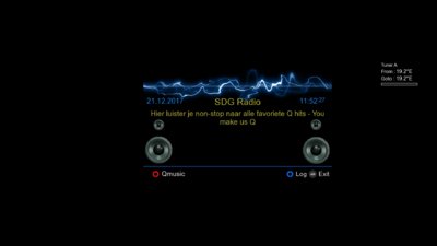

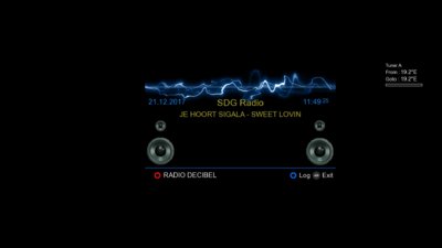

Большое спасибо Matrix10, я установил ваши файлы, а плагин
запустил SDGRadio на vuultimo4k vti_11.0.2_backup-image!
[URL = HTTP: //uploads.ru/3RYCr.png] http://s9.uploads.ru/t/3RYCr.png [/ IMG] [/ URL]
http://uploads.ru/3RYCr.png
[URL = HTTP: //uploads.ru/TDfiE.png] [IMG] http://s8.uploads.ru/t/TDfiE.png [/ IMG] [/ URL]
http://uploads.ru/TDfiE.png
My colleague with a message above wanted to thank you and say that I installed the plugin for the image of VTI 11.0.2 receiver Ultimo 4k.
We hope for further support of the plugin. I would very much like to have graphical visualization of signals, as it turns out on the computer.
And the request, is it possible to organize the channel switching (for example in the FM band) using the key CH+/-?
Thank you.

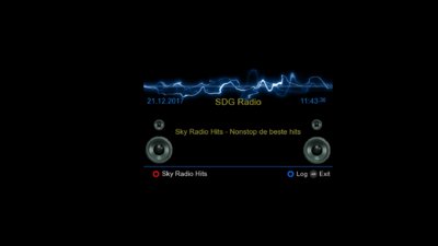

Experimental DAB/DAB+ radio
Thanks to @athoik
https://www.satdreamgr.com/forum/showthread.php?14653-RTL-SDR-with-Enigma2/page18
I made some modifications for Open Black Hole
I have test only with Open Black Hole ARM 4K box.
With this, only DAB/DAB+ radio stations can be received.
Ten NL channels have been programmed for testing.
Of course for use in other regions and countries
it is necessary to edit plugin.py
You have to put the names of the radio channels you want to hear
you have to replace the hex code of these radio stations
and the main code of the region.

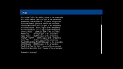

If you do not know the radio station code
just place the code for the region
and in the log you will see the codes and names.
