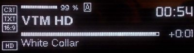

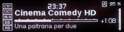

Here is the VFD skin that I made lately.
These are with SNR-bar and Tuner.
Except the files there are also two skin_user files.
One with the SNR on the side, and one with SNR on the top.
All files are free to use .
If you make changes, have noticed something that's not good or you made new skin please post here.
The skins with Picon's you can post on EvO's thread.
P.S. Please always make a back-up before overwriting any file.
Regards
Hija31
  • VFD_hija31.rar

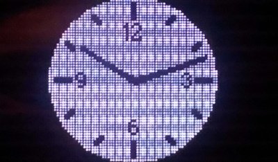

I made today a analog clock on stand-by menu.
What do you think.
This one is with seconds.

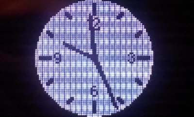

This without.

It's nice to see these new layouts and different idea's coming out now :)
I tried to make a white clock and black background which I think would look better but I can't get it to work.:wallbash::wallbash:
I can't change the clock at white . Standard, is black . If I try inverse I get a G.S.
Maybe someone from the coders have a solution, because that's over my head.
Matrix10
Upload here LCD skin file, with a black and white clock
so I can test if I have time.
Matrix10
I'm not sure if you want to have white clock,
Or clock needles ?
But OK
Here hija31 mod with white clock and black clock needles in Standby.
For black needles I'm not sure that we can get.
Because of image coding for analog clock.I have to test.
  • VFD_hija31_CK.zip
hija31
Or clock needles ?
I can't get white needles.
White clock with black needles as in photo above is working, but I think that white needles
with black clock would look much better ,
Matrix10
Yes, but I think that the color can not be changed.
I'll ask Coder maybe he knows more.
But white does not look bad .LCD is black.
hija31
That's what I think too.
Now we are using a white background for the clock to work. It would look great if the white colour was equal.
But on VFD some pixels are brighter then others and that spoils it.
On the other hand, with white needles we don't need a.png file because as you say the LCD is black.
The needles themselves are tiny so we don't get the disturbsion with pix-elation.

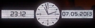

Here is a new test layout of the stand-by menu.

Hi Hija31.
Is it possible to upload here your last vork with analog clock in the middle and digital clock on the left and date on the right side?
It looks beautiful.
Thanks in advice.
