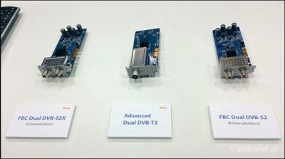

Advanced tuner system for any possible tuner configurationOne FBC tuner supports 8 demodulators. Two slots make it 16 demodulators totally.
  • Slot A : FBC DVB-S2X, FBC-C V1/V2 and Dual T2(MTISF) Tuner
  • Slot B : FBC DVB-S2X, FBC-C V2 and Dual T2(MTISF) Tuner
* FBC-C V1 Tuner can only be connected to slot A.

Si quires una foto, aqui la tienes, es publica/If you want a photo, here you have it, it's public.
(FBC connection) Dual DVB-T2
I think I have already understood the reason of this MTISF ... It seems that this tuner was designed on purpose for the Duo 4K, since this in slot A supports the tuner FBC-C (v1), not referring to the Hibrid DVB-C tuners / T2, Hybrid DVB-C / T2 H.265 and Dual Tuner DVB-C / t2. That is, not knowing if there is any technical impediment, there is no FBC T / T2 tuner.
After some research:
VU + MTSIF is a new type of tuner for Vu + receivers. The Vu + MTSIF is a DVB-T2 hybrid dual tuner for DVB-T, DVB-T2 and DVB-C standards. In addition, it is a new type of tuner working on MTSIF technology. According to some information, the tuner should work similarly to the FBC tuners up to a maximum of two frequencies.
