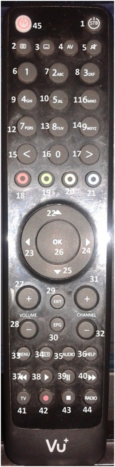

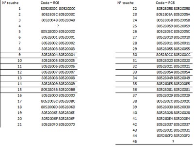

here is the full list of vuplus remote control codes? This can be usefull to emulate it when your remote is broken !
695209Sanstitre.jpg​
338206Sanstitre.png​
NB : key 4 and 45 can be programmed !
Please remember that the original Vu+ remotes send a toggle bit at the end of each command, therefore the above codes might not be sufficient to effectively program a universal remote if also the toggle bit is not correctly emulated.
thank's for replay !
what happen's if I send the same code twice ??
The second command (and any subsequent identical) is ignored.
For example, pressing an arrow key works only once, at least until another different key is pressed which resets the 0/1 toggle bit sequence expected at the end of the same repeated command.
