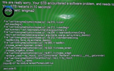

hello cher ami
no there is nothing strange even if the message seems old, the recommended plugin liniuxlcd4 download by blackhol 3.0.8, crashing my solo 4k (crashing green image and reboot without stopping) I had to install an old plugin and used the config file of our friend xrobertas and it works very well

Hi guys,
After installing LCDlinuxDuo4K on BH 3.0.9 C (VU Duo4K), I have a loop error that continuously resets the GUI.
Any help.

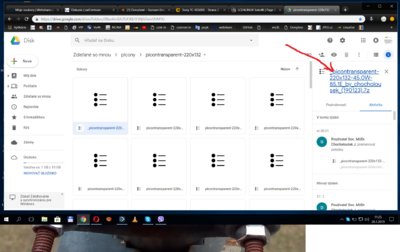

Hello I have a problem, I installed the plug-in apparently it works except that on the LCD screen the picons are not displayed. there is only the name of the channel but on my TV screen the Picon is displayed normally, please help me. Thanks
