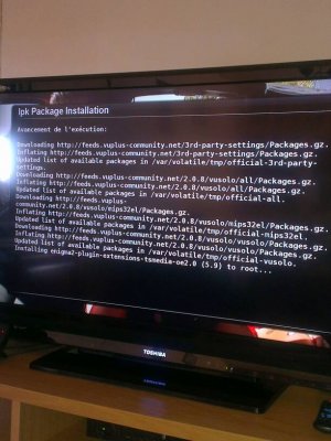

He have 5.9??? Are you sure What is Website is downloader please

Try installing 5.9 then updating to 6.0 from the actual plugin.TSMedia/Tools/Files Library/Tsmedia-oe2.0_6.0.Mine works a treat!
