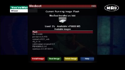

i was have usb and hdd in my box , in hdd i was have installed some images

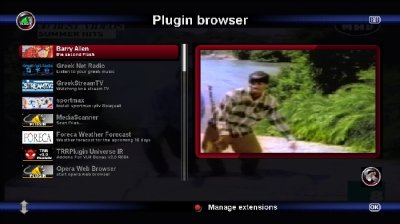

after barry allen installation i see in meoboot my installed images but i lost boot select image option for meoboot and i have not any boot screen from barry allen but plugin there is in plugins menu and barry allen choose my hdd for install no my usb i have them mounted us :

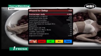

my barry allen setup is this am i have something wrong ?

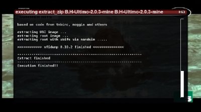

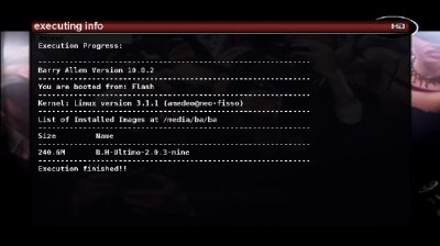

i follow @ Shiro tutorial and i install one mine backup black hole 2.0.3 image same with flash image

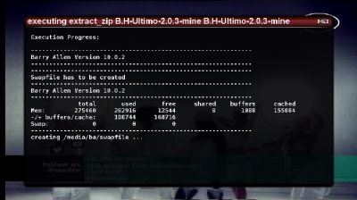

here is what happen with multiboot image installation

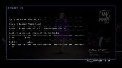

i select from barry allen menu to boot from multiboot but not success
what going wrong with my barry allen installation ?

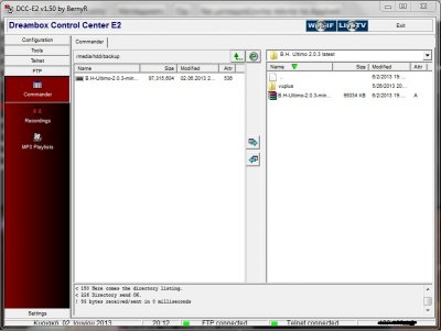

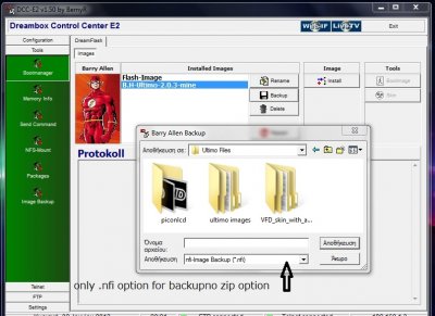

in DCC/Tools we have only options for .nfi image backup no .zip i hope added in the future , i want check and VuCC

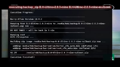

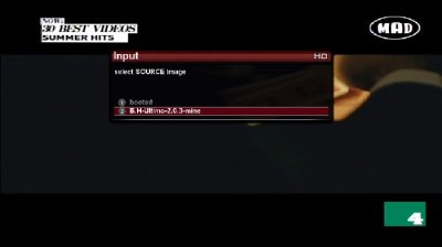

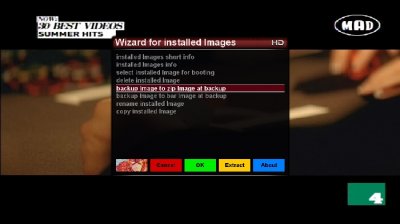

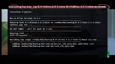

about backup zip options from barry allen menu us gutemine say work

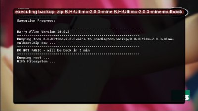

but create only 2 files [root_cfe_auto.bin and kernel_cfe_auto.bin ] no 3 like black hole backup tool : other 2 + [splash_cfe_auto.bin]

1) meoboot and barry allen are two different plugin.
you cannot mix barry allen and meoboot.
If you have a meoboot installation you have to delete meoboot and format the usb stick before to install barry allen.

3) About backup: splash_cfe_auto.bin can be omitted. It is only the splashlogo. So it is ok to have only the two files in ultimo (things are different for solo2).

i try boot vuplus image (multiboot) but boot flash image :(
also DCC show me i booted from vuplus image !!!
