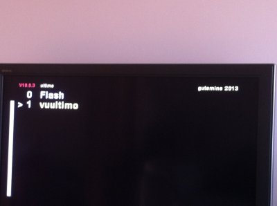

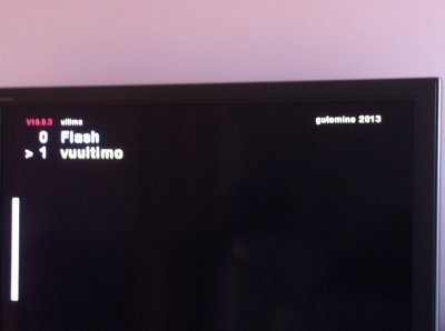

biskra who do you have wizard for setup ?
can you post one screenshot please?
gutemine who files from barryallen is for boot manager
for give me biskra if he want ?
@sat gr here is screenshot for ultimo barry allen

levi you're the best !!!!
i reflash my box from the beginning , i disable meoboot from setup wizard
after i follow your guide step by step and i have barryallen in my Ultimo after reboot !!!!
i thing something going wrong when i was try uninstall meoboot and install barryallen
thanks to all friends was help me
